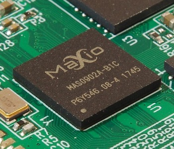

P.S. Уже после сдачи материала в публикацию решил наведаться на сайт Maxiotek, который долгое время совсем не радовал полнотой информации о контроллерах этой торговой марки (за которой, по некоторым данным, скрывается небезызвестная JMicron), и обнаружил интересный материал:
Maxiotek Corporation, a fabless solid state drive (SSD) controller design house participated in the 2018 CES(Consumer Electronics Show) to demonstrated the MAS0901, MAS0902 and all series of products, and announced the company begins mass-production of the MAS0902, a DRAM-less SATA 6Gb/s SSD controller, had widely adopted by plenty of the major SSD brands. “The SSD products using the MAS0902 will soon be available in the market,” Henry Chao the CEO of Maxiotek said.
The MAS0902 is a 2D/3D NAND supported DRAM-less SSD controller, designed for the growing SSD market segment that values performance as the major metrics. Maxiotek’s proprietary controller architecture paired with its intelligent firmware features such as AgileECC 2, WriteBooster 2, Virtual Parity Recovery, etc., pushes the performance of the MAS0902 to levels that compete DRAM-class SSDs in typical workloads. The read/write processing speeds of MAS0902 has almost reach the SATA 6Gb/s theoretical limit values. “The controller provides customers cost-effective solutions for their next generation SSDs by expanding the capacity up to 2TB, accelerating access performance, as well as improving reliability,” the company explained.
3D-NAND, a revolutionary technology versus the 2D-Planar NAND, allows better endurance, reliability, and higher density while it will drive NAND costs further down. “The 2D/3D NAND supported MAS0902 is your ideal SSD controller option to the SSD market,” the company added.
Comprehensive Support for 2D and 3D NAND with Superior Performance
The MAS0902 builds in dual processors to yield a satisfactory data transmission performance with the latest NAND flash memory, including 3D-MLC, 3D-TLC and 3D-QLC. Moreover, it supports 2D NAND flash memory. MAS0902 will be your best choice to tap into or expand the consumer and industrial SSD markets. And now it is exactly the right time to take action.
Так что перед нами действительно перемаркированный Maxiotek MK8115. Мало того, из этого пресс-релиза мы можем почерпнуть информацию о том, что этот контроллер получил поддержку QLC 3D V-NAND, появление накопителей на которой производители обещают в ближайшие месяцы.
