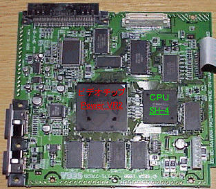

It is rise of the DC motherboard .
You looked at the various motherboard photographs on the net, but layout is somewhat different depending upon production time, but almost similar.
The tip/chip where the center is large video POWER VR2, the tip/chip where that right side is a little small is CPU SH-4.
When you inspect also the power source basis of DC, it is 12V 5V 3.3V
(As for 3.3V it is not in power source of the personal computer, but it is made on the DC motherboard.)

The foot the cord/code is attached to pattern of the pin and the baseplate of PLL-IC which was lifted.
Because with just the solder there is an insecurity in strength,the cord/code is locked at the hot bond.
Because (generality, the stranded wire of the cord/code is dangerous, be sure to use the single core cord/code.)
In order to decide the clock, connecting CD-ROM, it does actual operation check.
(While operating, CD-ROM high being to turn above expecting, note is necessary.)
As for リプレイ whose processing is heavy, being SAVE not to be done in visual memory, with who? You verify in the demonstration play immediately after the power source throwing which you can verify.
