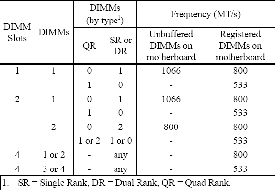

In this article I would like to tell about one of the most important applications of WPCREDIT - tweaking integrated A64 controllers and Barcelona in particular. Due that Intel desktop chipsets are using PCI-E registers, we can ask about whether the usage of WPCREDIT is actual in nowadays, what has been done in the discussion of my previous article about WPCREDIT. But there are AMD processors that have the north bridge, integrated into the CPU. One of the most important components of the north bridge is the memory controller (DCT). And all of his settings are just inside the PCI registers of the north bridge (0,0,0).
This is an English version of the article. Russian version is available here.
Barcelona
So what interesting innovations are represented in the new AMD microarchitecture? First of all, it’s the two memory controllers, each with a 64-bit bus working with its own memory channel. This means, we can set different timings for different memory channels, but the memory frequency must be the same. The processor may be configured to behave as a single dual-channel DCT; this is called ganged mode; or to behave as two single-channel DCTs; this is called unganged mode. The ganged mode is similar to the behavior of the K8 processor memory controller. I want to mention, that according to AMD terminology: a DRAM channel is the group of the DRAM interface pins that connect to one series of DIMMs. The processor supports two DDR channels. The processor includes two DCTs. Each DCT controls one 64-bit DDR DIMM channel (BIOS and Kernel Developer's Guide (BKDG) For AMD Family 10h Processors, p.60). We can get a clue about the influence of the number and type of memory modules on the maximum supported frequency from the picture:
